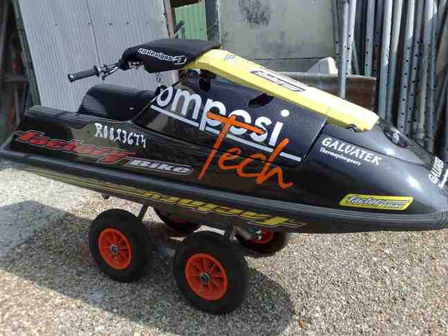

Nu hara jag fått hem min nya jetski !
Den är av märket Coimposit Tech och är gjord av 100% Carbonefiber.
Skrovets vikt är ändast 29kg !!!!!!!!!!!!!!!!!!
Det siter en Dasa 800cc motor i denna jetski med Solas magnum pump.
Ny så kostade skrovet 15000euro och skrovet kommer ifrån 2008. Företaget tillverkade detta skrov mellan 2006 till 2009 innan de la ned tillverkningen.
Företaget som tillverkade denna jetski gör idag delar till Euro fihgter och till formulet F1 bilar.
Lite info ifrån tillverkarens hemsida
Compositech now Applying Expertise to Personal Water Craft for Jet-Ski Hulls - March 2006
French company Compositech, which is experienced in manufacturing composite parts for high performance automobiles and industrial applications, is now applying its expertise to personal water craft for jet-ski hulls.
Compositech has achieved dramatic reductions in the weight of their latest jet-ski hull design by the use of ACG's LTM® and VTM® composite prepreg materials. Curing at temperatures as low as 40°C, ACG's materials are clean and simple to lay-up, allow for greater freedom of design and ultimately create lightweight structures of great strength and stability.
By their innovative use of Formula One manufacturing methods and carbon composite materials Compositech has designed and built a hull that is almost 50% less than their previous 56kg design. This dramatic weight saving has allowed an equally dramatic improvement in performance as demonstrated by their world renowned pilots Pierre Maixent and Gil Beurnier. They praise its performance characteristics while acknowledging that some time is required to adapt to its lightness and precise manoeuvrability which make it ideal for the regular freestyle competitor.
The use of carbon composite materials has allowed the Compositech design to achieve a more streamlined shape to the top of the hull, the premier modification being that the dashboard is an integral part of the carbon structure, improving the visibility and control of the jet-ski.

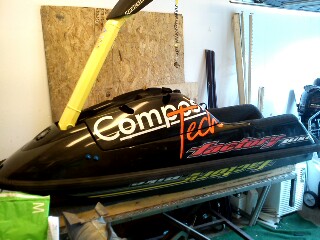

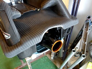

Inläggav jetski » 14 augusti 2011, 07:24
Den är byggd efter en superjet men har små föräöndringar under skrovet. Mera bilder kommer.
Re: Composite Tech CY7 superjet 100% kollfiber

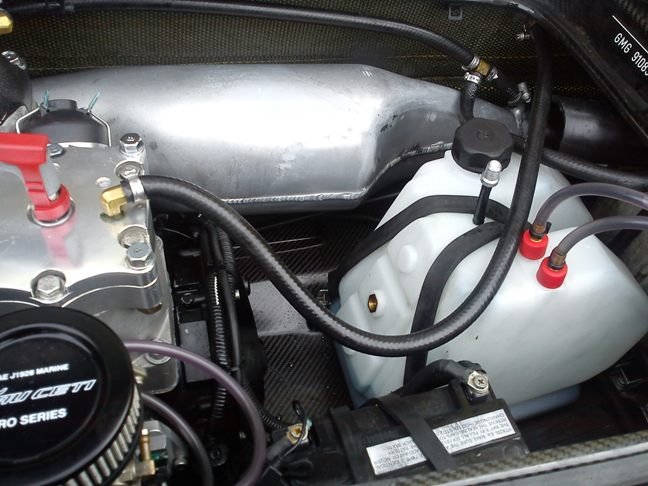

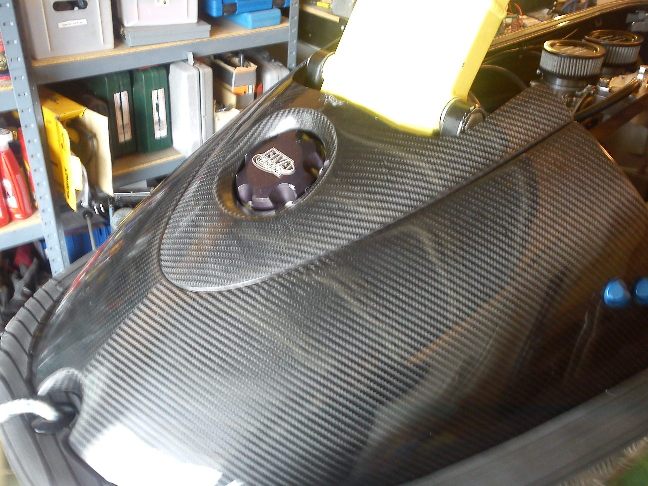

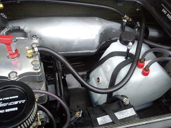

Inläggav jetski » 14 augusti 2011, 20:41

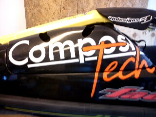

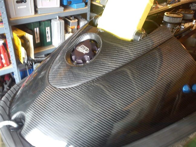

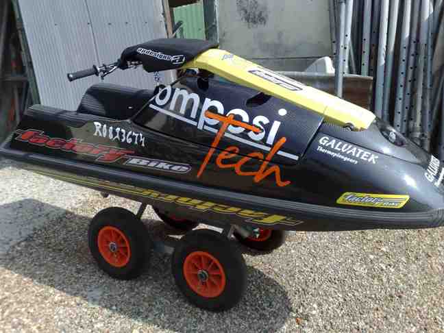

Har nu varit ute och kört med jetskin. F...A....N vad den gick.
Kund konstatera att tilten ska jag vänta med tills jag klarar av maskinen ! Var tvungen att testa tilten då jag gasade en gång. Detta sluta med att jag såg bara himel innan jag landa på rygg. Nu förstår jag hur lätt det kan vara att få till backflip med rätt maskin (man ska ju bara våga också).
Negativt är att det sitter bara en 5 liters tank och det går fort att köra upp denna.
Motorn håller jag på att kolla upp då jag är osäker på hur många kubik den är på.
Förra ägaren sa lite över 800cc men hur mycket ???
Lite mera bilder.

Är den lika lång som en original superjet eller är den kortad?
Inläggav jetski » 15 augusti 2011, 17:57
2 cm kortare. !!!! Men när du kör den så känns den otroligt kort för den är så snabb att svänga med.

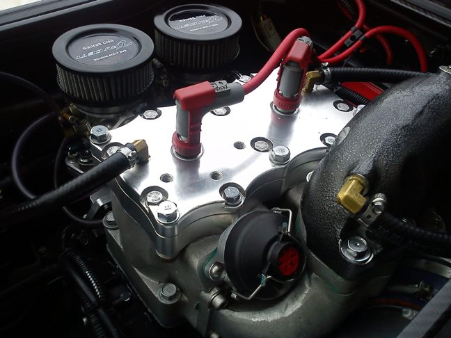

'Håller nu på med att söka efter nya domes till motorn så jag kan köra på vanlig bensin. Idag går den på 105 octanig race bensin.
Det är en DANA top som sitter på motorn.

Har varit i kontakt med DASA Racing för att se hur jag ska bygga om jetskin till 99 oktan för att slippa köra på 109 oktan.
Enligt DASA så levererar denna DASA motor idag ca 170+ HK och bygger jag om den så kommer den att leverera 160+ HK.

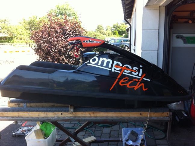

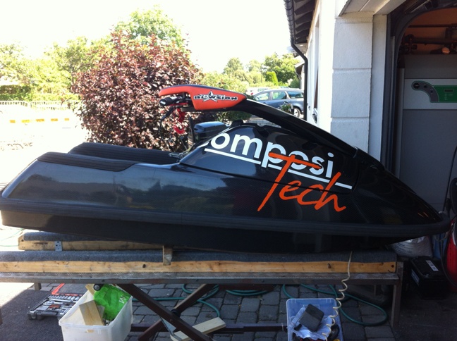

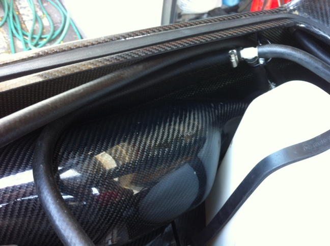

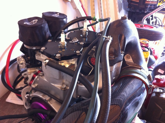

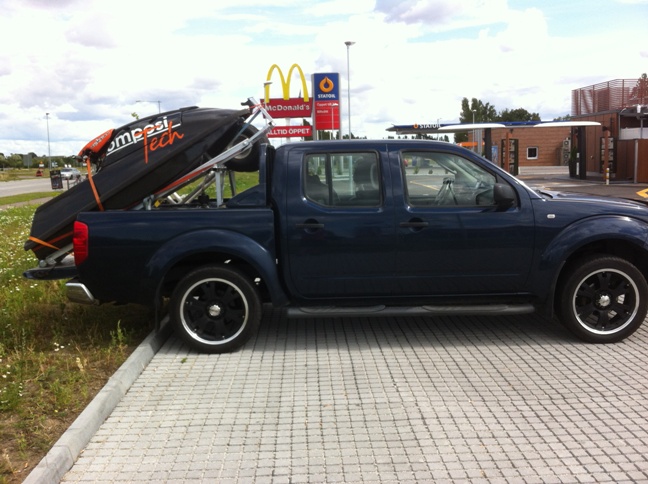

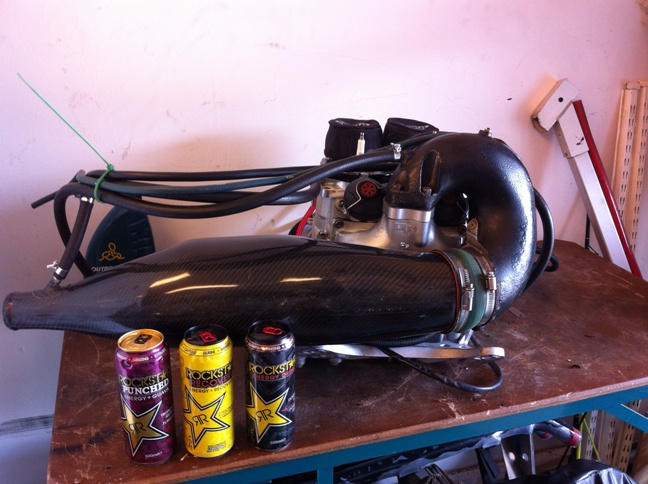

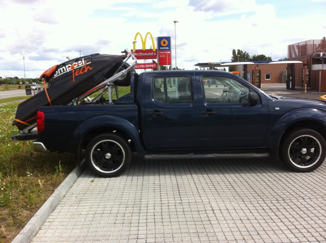

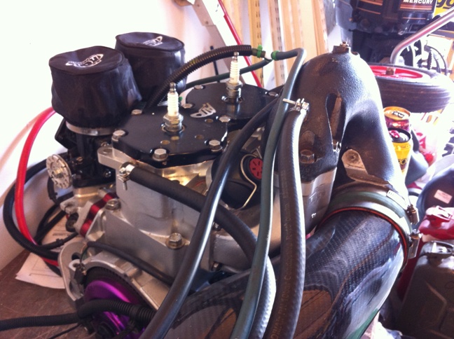

Inläggav jetski » 15 augusti 2012, 10:30

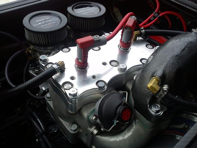

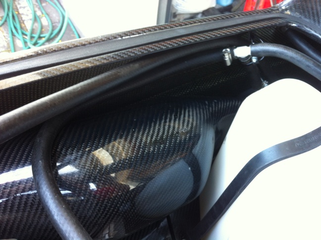

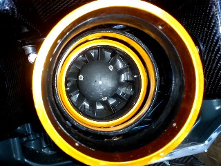

Lite bilder !!
1= lastad och klar för lek !!!!!!
2= står på min ombyggda sjukhus säng för genomgång !

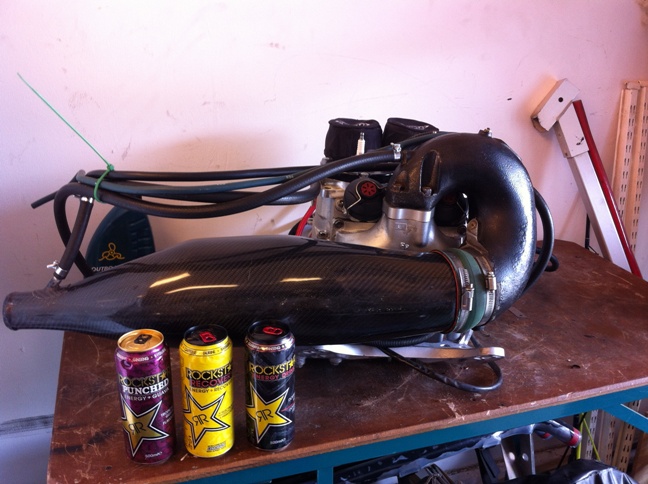

3= DASA motor med Kolfiber factory B pipe
4= DASA motor innan installation
Lite mera godis som finns på min maskin !
-Factory B pipe i kollfiber
-Ny DASA motor med 5mm strok (inställd för 98 eller 99 octan bensin)
-Ny Magnum pump med impeller för free ride. Nu har maskinen bättre resbons genom hela varvtals registret.
-Nu Blowsion pad (special beställd).
-Orginal bom kortad 6 cm ( detta för den är lättare än RRP och Startbar).
-0 gradigt styre
-Osv
Och klart att min jetski bil får vara med på bilden.
