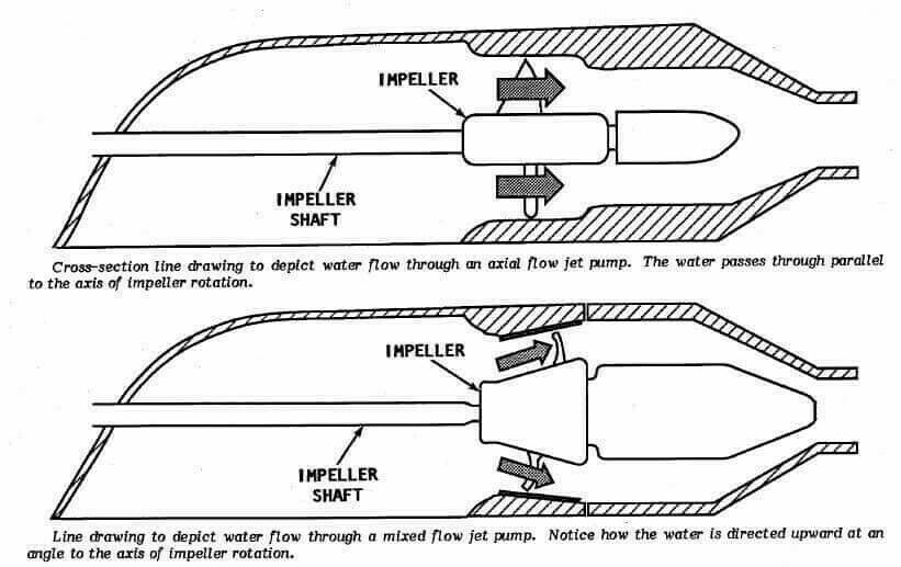

Fick en förklaring på varför många kawasaki 550 jetski har 300/440 pumpar,jag har hört att dom är bättre
men ingen har sagt på vilket sätt men detta fick jag vet nyss.
Some 550's have 440 pumps because people change them sometimes, because the 440 pump design is better like the 650 and 750 pumps "axial" design,
and a 550 is a "mixed flow" design.
The 440 pump will allow the engine to spin a higher rpms and process more water at a time to make thrust, whereas the 550 pump is like squeezing your thumb
over the end of a water hose to make thrust. here are the two designs. in this diagram you can see how the water changes direction more times in the mixed flow design
whereas its a straight though flow in the axial flow design.
